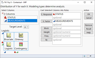

Hello everyone, can someone please outline the steps on how to obtain a risk ratio with 95% confidence interval and p-value? I tried to follow the directions on the JMP help site but I do not have the risk ratio option in the "Fit by Y" Contingency Analysis. I have JMP pro 15. Thank you for your time and help
Thierry_S
Re: Finding Risk Ratio Help
Hi,
Based on the limited information you provided, I assume that you are looking for Odds Ratio in the Fit Y by X > Logistic Fit platform. If it is the case, read on, otherwise please provide more details.
  1. Table format:
    1. Your Ys are categorical values (e.g., YES, NO; or A, B) stacked into one column (in my example: STATUS)
    2. Your Xs are continuous values stacked into a second column (in my example: MEASUREMENTS)
  2. Platform:
    1. Go to Analyze > Fit Y by X
    2. Set your categorical column as Y
    3. Set your continuous column as X
    5. Click OK

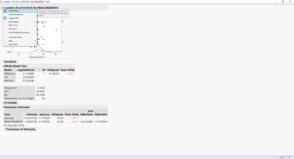

  3. Expand Analysis:
    1. In the top left menu, select: Odds Ratio
    3. The Parameters Estimate will give you the Odds Ratio for the levels included in the Ys.
I hope it helps.

Hi,
  1. Table format:
  2. Platform:
    5. Click OK
  3. Expand Analysis:
I hope it helps.

jmpquestions123
Level III
Thank you very much for that information, I was able to find the odds ratio with your help!
