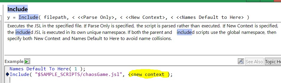

see if this does what you need; In the example, if you run it twice, it makes two independent windows rather than two that interfere with each other. Also, I'm not sure what RunJSL(1) does in the include() function...I think it is ignored.
include( ... , <<new context )include( ... , <<new context )
