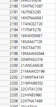

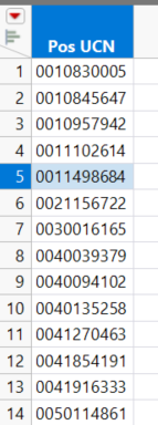

They have to be character values because I need the leading 0's.

I was talking about these:

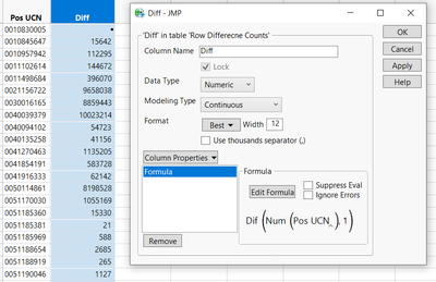

To get the difference between 2 rows, then you have the formula below.
If you want to make sure that your line is at least 10 away from all the other lines, you can do this as follows:
- Convert your column into a number (see what we do with characters)
- Arrange your column in ascending order
- Create the Diff column using the formula above and check if there are some diff < 10

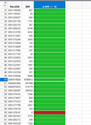

Thank you. This gives me a count difference between rows. Now how do I highlight rows that a difference of less than 10?
Re: Find row differences

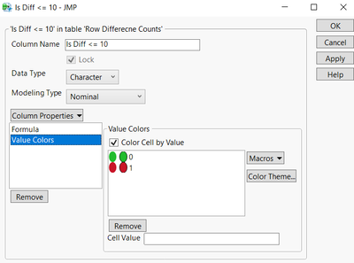

In the same way, you can create a formula as below to get if the difference is less than 10 (1) or not (0) in a new column
And use color values property to highlight rows with less than 10 of difference

So I was able to make my two additional columns (Diff and Prev UCN <=5). But I want to be able to get both the numbers. So for row 6345, it identifies as a previous row within 5, but I want to also identify that row before (6344)? This is looking for a "Pos UCN" +/- 5 to see if there are numbers that are close together. If they are close together, I want to identify both so I can look further and determine any potential issues.
