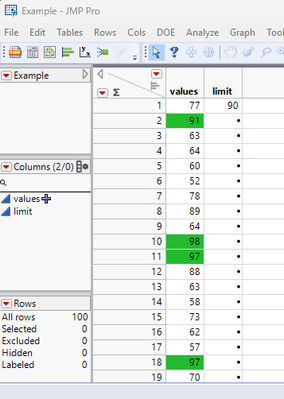

Here is an example of how I would approach this
names default to here(1);
dt=New Table( "Example",
	Add Rows( 100 ),
	New Column( "values",
		Formula( Random Integer( 50, 100 ) )
	New Column( "limit",
		Numeric,
		Set Values(
			[90]
dt:values << color cells(green,dt<<get rows where(:values > :limit[1]));
Jim
	Add Rows( 100 ),
		Numeric,
		Set Values(
			[90]
Jim
