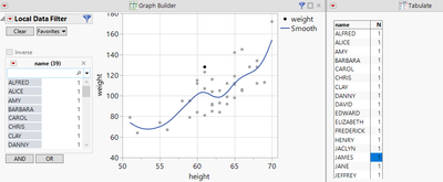

A nice feature in Jmp:
One (main) graph can be used to restrict the data that is displayed in another graph - or tabulate list.
This feature is activated by a checkbox "Filter By":
Surprisingly, activating a Local Data Filter in the (main) Graph  disables this functionality.
The respective data points are just highlighted, the display is not restricted to the selected data points:
Same effect in Jmp 16 and 17.1.
Why is the functionality disabled by activating a Local Data Filter.
How can I enable the functionality?
Workaround:
Add another Data Filter (outside of the main graph).
how?

hogi
Level XIII
Re: Filter By - disabled by a Local Data Filter
Hi @yuichi_katsumur ,thanks a lot for the solution.
So, the trick is to add a level with a second Data Filter Context Boxes ...
Are the nested data filter source boxes necessary. It seems that a single one is also fine:
Jmp support just confirmed:
In Dashboard mode, there is no possibility to generate the hierarchical structure which is needed to make this Dashboard work :(
(Case 00045639)
