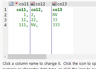

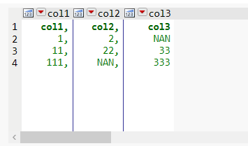

Might be just case with small .csv file, but JMP seems to be able to convert some already (NA and NAN at least)

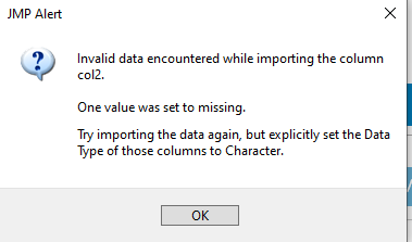

This isn't recognized, but you can force character columns to be numeric
You will get a message about ONE of the columns
This most likely interrupts the operation from affecting other column (otherwise could work?). Now you would have to modify the script JMP creates for you (update all columns to be numeric)
