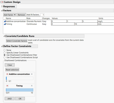

Looking at your topic, I think you might be interested to look at "Disallowed combinations" option in the Define Factor Constraints panel.
Trying to reproduce your experimental setup with the two factors, if I add a constraint through the Disallowed combinations filter that experiments with an additive concentration close to 0 and a timing higher than 0,01min (or any very low value close to 0) shouldn't be part of the design, I can generate a design corresponding to your needs :

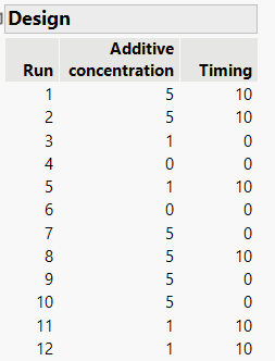

And here is the resulting design for estimating main effects and the 2-factors interaction :
No experiments in the design have a timing different from 0 when additive concentration is set at 0.
