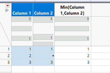

Hi I want to get some advice of combining columns.
Here I have column 1 and 2 and these two columns are actually containing the same info of interest. I want to combine them together and remove repeat info.

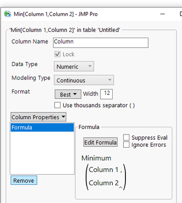

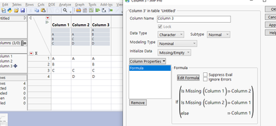

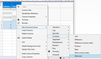

If they are numerical categorical you can still use that kind of approach. If they are characters, there are still many different options and which to use can depend a little bit on your data, below is one simple example
If(
Is Missing(:Column 1), :Column 2,
Is Missing(:Column 2), :Column 1,
:Column 1
-Jarmo
