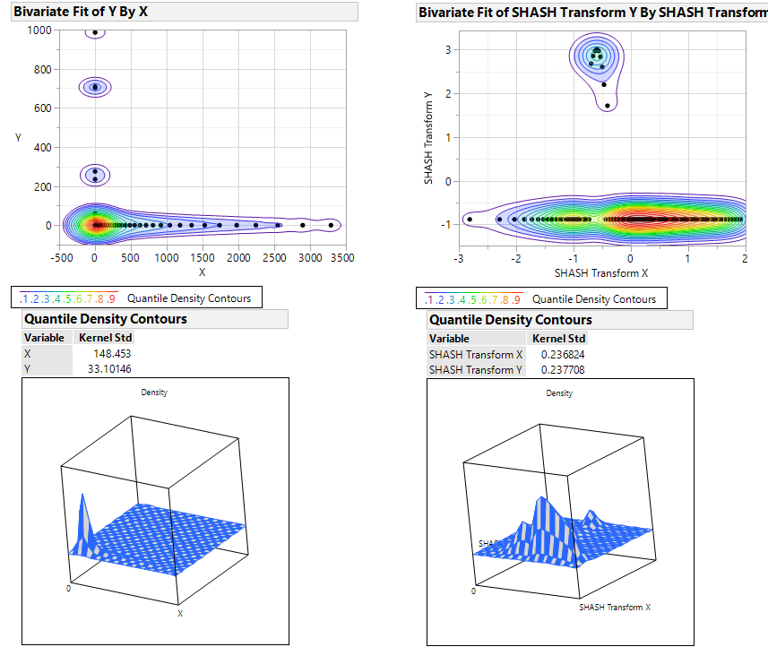

Re: Failing Normality Test
using @garibay90 's data, I used Fit Y by X instead of Graph Builder because the platform offers more options for coloring and changing the contour lines.  Also discovered this "Mesh Plot" option which looks like a Bivariate Histogram.
