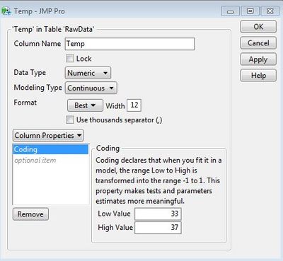

You can set the CODING property of the columns for the factors:

Many thanks David! It worked. Marcello.
