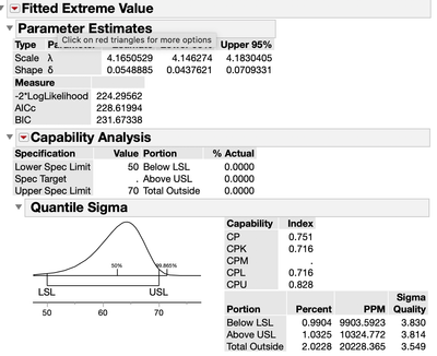

I'm looking for some information on the "Extreme Value" distribution type, found in the Distribution Platform under Continuous Fit.  Specifically, what is the formula for this cumulative distribution?  Here's an example:

Here's a pic of the fit in the Distribution report.  There are two parameters, lambda and delta.
I checked the "JSL Syntax Reference > JSL Functions > Probability Functions".  The closest functions I can see are the "SEV Distribution" and "LEV Distribution", which both also take 2 parameters in addition to the independent variable x.
However, the values I get using either of these functions with the parameters in the Distribution report do not jibe.  E.G: at my LSL of 50, the report says 0.9904% of the distrubution is below my lower limit.  However:

Both functions return a probability of 100%.  In fact, they remain 100% unless I lower x to ~4.   So clearly either these aren't the right functions or I'm missing something.
Any ideas?
