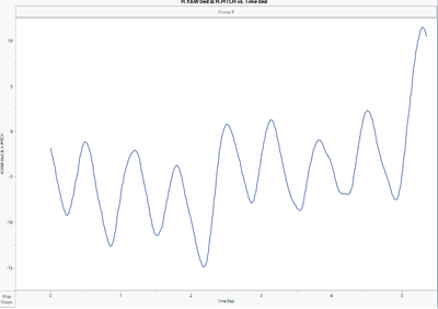

Hi I have some motion data of cyclic movement measured as angle over time. Is there a way to extract the minimum and maximum peak values (I am a noob so a simple explanation is possible please). An example below. I have been doing it manually but I have some data with a large number of peaks so would like a more efficient way. Many Thanks

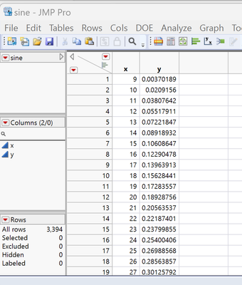

The table it produces looks like
The data table I created has two column.  One called X and one called Y  The columns can be named whatever one would like to call them.  The script just has to be changed to swap out the references to the column names of X and Y to whatever the actual names of the columns are.

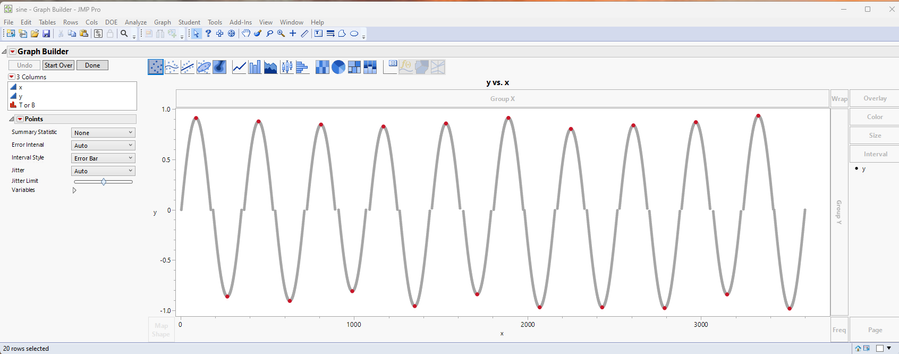

Getting back to the actual script that I provided....once the data table is created, I then used Graph Builder to display the data in a graphical form.
Graph Builder( Variables( X( :x ), Y( :y ) ), Elements( Points( X, Y, Legend( 3 ) ) ) );
This JSL statement displayed the sine wave graph.
The next statement simple pauses the execution of the script, to allow one to see the graph for 5 seconds, before moving on to the actual searching for the minimum and maximum values in the data.
Wait(  5 );
Theremainder of the JSL, is the actual working part of the code, that first finds the maximum and minimum point of each sine wave, and then creates a new data table containing just the

dt << select where( :T or B != "" );
dtTB = dt << subset( selected columns(0), selected rows(1));

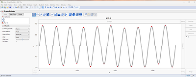

Here is an example that finds the top and bottom peaks for the sine waves.  The script first generates some example data and then goes and finds the top and bottom peaks.
Names Default To Here( 1 );
dt = New Table( "sine", New Column( "x" ), New Column( "y" ) );
For( k = 1, k <= 10, k++,
	yfudgepos = Random Uniform( 0, .2 );
	yfudgeneg = Random Uniform( 0, .2 );
	For( x = 0, x <= 360, x++,
		dt << add rows( 1 );
		y = Sin( x / 180 * Pi() );
		:x[Row()] = x + ((k - 1) * 360);
		If( y < -1 * yfudgeneg,
			:y[Row()] = y + yfudgeneg
		If( y > yfudgepos,
			:y[Row()] = y - yfudgePos
dt << select where(ismissing(:y));
dt << delete rows;
wait(5);
// Find the min and max for each phase in the sine waves
dt << New Column("T or B",character);
// determine the starting direction of the wave
if(dt:y[1]<dt:y[2], direction = "up", direction = "down");
For( i = 1, i <= N Rows( dt ) - 1, i++,
	If(
		direction == "up" & dt:y[i + 1] < dt:y[i],
		show(i);
			dt:T or B[i] = "Top";
			direction = "down";,
		direction == "down" & dt:y[i + 1] > dt:y[i],
			dt:T or B[i] = "Bottom";
			direction = "up";
Jim

Thank you so much for this. Sorry for the silly questions, how do I then apply this to my data. Also could you explain why there is a little step along the 0?
Thanks
