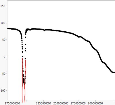

I have a data table that plots the below.  I need to find the corresponding x values for the points that are nearest to y=0.  I need the first two points (red lines) that cross (nearest) zero, the third crossing is not of interest.
I can find the closest value using the script:
value = 0;
d = Abs((:"col" << get values) - value);
rows = Loc(d == Min(d));
Show(rows);
Data Table( "DT" ) << select rows(rows);
This returns the value that is closest to the zero line regardless of when it crosses.
These two x-values will go into the dt as a new column and used for further calculations.  Am I on the right track with the above script?

txnelson
Re: Extracting data from Graph/Data Table
I think the way that you need to approach this is to pass through the data, and then find the first and second time the data cross zero.  When the data crosses 0, then find which of the values is the closest to zero and then record the value and the row.  Then repeat for the second occurrence, and then stop reading.  Finally select the found rows.  Here is a simple script that does exactly what I described above:

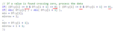

I have another question.  I have another parameter I am collecting from my data set and have created a summary table that finds the max value for that parameter.  From there I take half that value and record this in a new column ("half value").  I would like to use the half value in the script to get the corresponding x values for each Part ID:
Each Part ID will have a different half value.  The above is the section of the script where the half value  needs to be inserted to obtain the corresponding step value.  I'm having trouble getting the half value into the script properly and indexing through each Part ID and it's associated half value. What's the best way to insert the correct half value into the script for each Part ID?
txnelson
If I am interpreting correctly what you are asking, I believe the easiest way to take your summary table and to do a Tables==>Join matching on Part ID.  It will add the Max value to each row for the appropriate Part ID
Jim

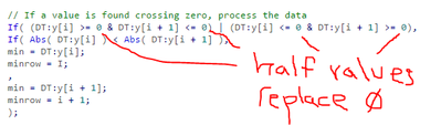

bhosse0
Level II
Since I'm taking half the value of the max there is no corresponding data value in the data table to match and get the x value.  I have done this to get the x value that goes with the max, but now the is not a value that matches since it is a calculated value.  I am trying to use the half value as the value to extract the corresponding x values.  Similar to the above script where it gets the values that cross at zero, I need to get the values that are closest to the calculated half value.  I was trying set the half value as a variable for each Part ID and step through each Part ID and get the values closest to the half value:
This would work simlar to the script above that get the values nearest zero except it would get the values nearest the half values which is calculated for each Part ID.
txnelson
If you take the data from the summary table that you said you have calculated and perform a Tables==>Join    that data to your original data table, then you can reference in your script.  Or if you manually add the data in, that will work to.  So if the column that  is called "Half Value"  there will be a value for "Half Value" for each row, then you can change the "0"s to
   Half Value and Half Value[I+1]
If( (dt:y >= dt:Half Value & dt:y[I+1]<=dt:Half Value[I+1]......................
