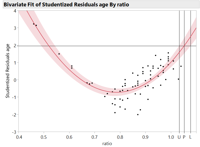

Craige_Hales
Re: Extract factor range from bivariate graph
minor variation
offset = 1.96;
// (I do not know how to pick these without a visual examination of the result.)
startingPoint = 1.1; // or 0.5 (trial and error. pick something close and check.)
// example data set
dt = Open( "$sample_data/Growth.jmp" );
// fit first-order polynomial model to response
biv = Bivariate( Y( :age ), X( :ratio ), Fit Line );
// save residuals for next step
biv << (Curve[1] << Save Studentized Residuals);
biv << Close Window();
// fit second-order polynomial model to residuals
biv = Bivariate( Y( :Studentized Residuals age ), X( :ratio ), Fit Polynomial( 2, {Confid Shaded Fit( 1 ), Line Color( {212, 73, 88} )} ) );
// save formulas for lower / upper 95% confidence bound
biv << (Curve[1] << save predicteds);
biv << (Curve[1] << Mean Confidence Limit Formula);
// get formulas, using order columns were saved
fupper = Column( dt, N Cols( dt ) ) << Get Formula;
flower = Column( dt, N Cols( dt ) - 1 ) << Get Formula;
fpredicted = Column( dt, N Cols( dt ) - 2 ) << Get Formula;
// replace predictor name with x
fsupper = Substitute( Name Expr( fupper ), Expr( :ratio ), Expr( x ) );
fslower = Substitute( Name Expr( flower ), Expr( :ratio ), Expr( x ) );
fspredicted = Substitute( Name Expr( fpredicted ), Expr( :ratio ), Expr( x ) );
fsupper2 = Substitute( Expr( a - offset ), Expr( a ), Name Expr( fsupper ) ); // find zero at offset
fslower2 = Substitute( Expr( a - offset ), Expr( a ), Name Expr( fslower ) ); // find zero at offset
fspredicted2 = Substitute( Expr( a - offset ), Expr( a ), Name Expr( fspredicted ) ); // find zero at offset
// initialize x, could get x that predicts mean residual = 0
x = startingPoint;
// minimize expression that is Abs( residual ), or mean = 0
faupper = Insert( Expr( Abs() ), Name Expr( fsupper2 ) );
Minimize( faupper, {x} );
xupper = x;
Show( xupper, Eval( faupper ) );
x = startingPoint;
falower = Insert( Expr( Abs() ), Name Expr( fslower2 ) );
Minimize( falower, {x} );
xlower = x;
Show( xlower, Eval( falower ) );
x = startingPoint;
fapredicted = Insert( Expr( Abs() ), Name Expr( fspredicted2 ) );
Minimize( fapredicted, {x} );
xpredicted = x;
Show( xpredicted, Eval( fapredicted ) );
// add lines on plot
Report( biv )[axisbox( 2 )] << {Add Ref Line( xpredicted, "Solid", "Black", "P", 1 ), Add Ref Line( xupper, "Solid", "Black", "U", 1 ),
Add Ref Line( xlower, "Solid", "Black", "L", 1 )};
Report( biv )[axisbox( 1 )] << {Add Ref Line( offset, "Solid", "Black", "", 1 )};
Report( biv )[framebox( 1 )] << Frame Size( 752, 513 );
Low sideLow sideHigh sideHigh side

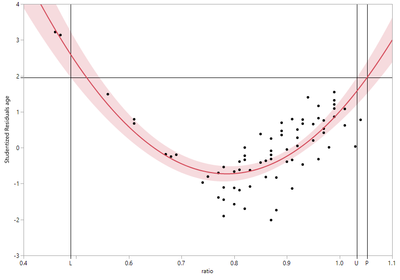

pauldeen
Level VI
I tried desperatly to come up with a algorithm for the starting point, for example I used the quadratic formula to calculate the predicted curve crossing with 1.96 and even if you plug that number in for the starting condition you get fairly unpredictable behavior:
So thanks for showing how it can be used and I did learn a lot from this example, but it is not robust enough yet.

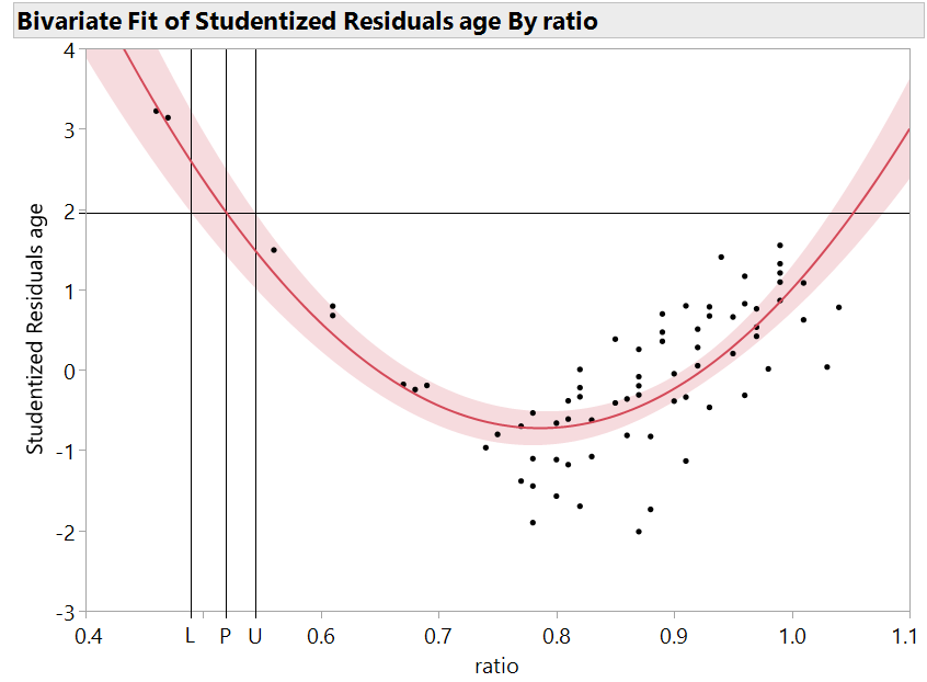

Craige_Hales
I think the problem is with the absolute value function making a curve that doesn't have a nice derivative, making minimize likely to fail. I was hoping @ih  idea would force minimize to stay in the right neighborhood, but maybe not.
I don't have time to puzzle through it right now; it seems likely there is a standard alternative to abs() for this problem...yielding a smoother function. (maybe squaring it? something like that.)
Edit: and your result agrees with mine, which is why I had the comment about visual inspection. The abs function makes a corner in the function to minimize, and the slope near that corner is used by the minimize function, and it expects a continuous (2nd?) derivative on each side of the answer. Since the slope instantly flips on each side of the true answer, it is amazing it gets close answers sometimes. I think the message in the log may be because of this.
