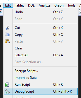

If JMP14 did have Debugger (and you can get that working as that might not be that easy) you could also try that
![jthi_0-1717003401520.png jthi_0-1717003401520.png](https://community.jmp.com/t5/image/serverpage/image-id/64627iC0B7AA57EB3252CC/image-size/medium?v=v2&px=400)
