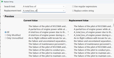

Other option would be to change the phrase "destroy up to one target" into a single phrase "destroy_up_to_one_target" - right now the text explorer is splitting the individual words up, and because none of the end terms dominate (ie theres not loads of 'target creature') theyre being placed as single entries. If you convert as 'destroy_up_to_one_target' it will float up 'destroy_up_to_one_target creature//enchantment' or similar. You can use Column > Recode> Replace String and do similar to the screenshot below:

Just wanted to give you kudos and let you know the manual recode worked, extremely well. Every time that I found a phrase that seemed to be missing a word at the end, I simply recoded the phrase to be one word with underscores and re-ran the analysis with the same settings. Each time, the phrase I was looking for showed up. For example, after "At the beginning of each opponents" was recoded to "At_ the_beginning_of_each_opponents" and moved to the term list, the next time I ran text explorer it found "At the beginning of each opponents upkeep", which is what I was looking for in the first place. My corpus and the phrases I am looking for is small enough that I can probably make these type of manual recodes in about 20-30 places and effectively find all of the terms I am looking for. For smaller analyses like this, I feel like I was just given a "hack" that I will use over and over again. I am grateful.
