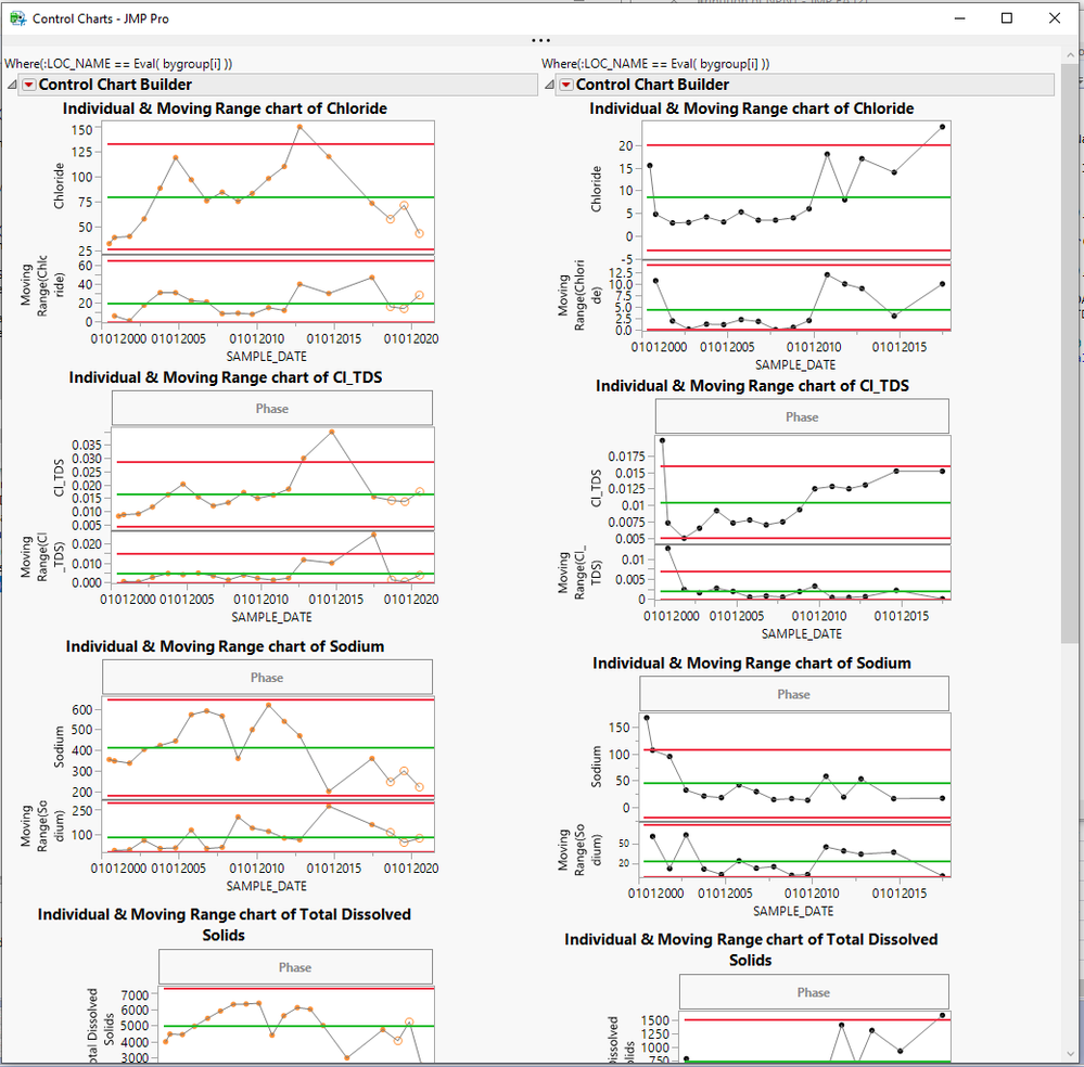

Thank you for the idea. I changed the script a bit to include a Lineup box. At first I tried with multiple unique names ine the 'by' column. However it was putting a different sample in the second column, rather than splitting up the 6 graphs for each unique name into 2 columns of three. See attached photo.

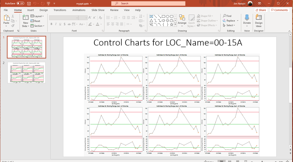

So I tried again using only one unique value to see if it would split the six graphs into 2 columns and it exported the one unique value in a column of six graphs. It still didn't separate into 2 columns. What am I doing wrong?
