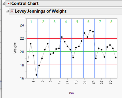

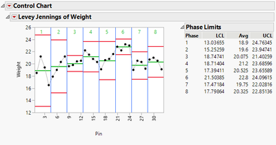

Did you try it?  If I do not use the limits file, I get this.
If I do use the limits file, I get this.
My limits file is specifying JMP to use the same limits for all phases, but the limits given in the file ARE used.

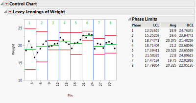

by the way, I ran your script and didn't get the same plot.
this is what I got
