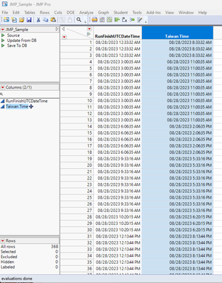

Hello,
I am attaching a table here with the first column showing UTC date\time. How do I use JSL to generate  a column called Taiwan Time by adding 8 hours to the 1st column?
Thanks, Cryz
txnelson
Re: Adding hours to existing date/time column
Use the In Hours() function to add the hours.
:RunFinishUTCDateTime + In Hours( 8 )
JMP Date/Time values are measured in the number of seconds.  Therefore, the following formula would also work
:RunFinishUTCDateTime + 8 * 60 * 60
