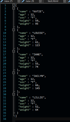

jthi
Re: Export JMP Table as JSON
To which format should this JMP table be changed to
New Table("Untitled",
	Add Rows(5),
	Compress File When Saved(1),
	New Column("name",
		Character,
		"Nominal",
		Set Values({"KATIE", "LOUISE", "JANE", "JACLYN", "LILLIE"})
	New Column("age",
		Numeric,
		"Ordinal",
		Format("Fixed Dec", 5, 0),
		Set Values([12, 12, 12, 12, 12])
	New Column("sex",
		Character(1),
		"Nominal",
		Set Values({"F", "F", "F", "F", "F"})
	New Column("height",
		Numeric,
		"Continuous",
		Set Values([59, 61, 55, 66, 52])
	New Column("weight",
		Numeric,
		"Continuous",
		Set Values([95, 123, 74, 145, 64])
  "name" : "KATIE",
  "age" : 12,
  "sex" : "F",
  "height" : 59,
  "weight" : 95
  "name" : "LOUISE",
  "age" : 12,
  "sex" : "F",
  "height" : 61,
  "weight" : 123
  "name" : "JANE",
  "age" : 12,
  "sex" : "F",
  "height" : 55,
  "weight" : 74
  "name" : "JACLYN",
  "age" : 12,
  "sex" : "F",
  "height" : 66,
  "weight" : 145
  "name" : "LILLIE",
  "age" : 12,
  "sex" : "F",
  "height" : 52,
  "weight" : 64
Isn't the row order is preserved based on the order of items in the list?
-Jarmo
