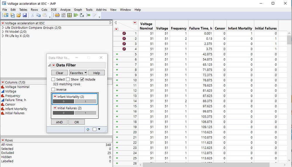

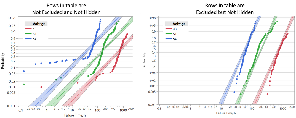

I am trying to Exclude rows from analysis in Fit Model, Life Distribution and Fit Life by X platforms.
In all platforms mentioned above excluded row are also appear to be hidden in graphs, while in table these rows are only excluded.
Question: Why excluded rows are also become hidden in Fit Model, Life Distribution and Fit Life by X platforms?
For more details see screenshots below and attached JMP file.

The described convention only applies to "raw data points", which can be plotted, no matter they are excluded from analysis or not, as long as not hidden.
Here in Fit Life by X etc., the markers are not "raw data points", they are non-parametric estimate of distribution function. They are computed with and corresponding to the observations that are included in the analysis.

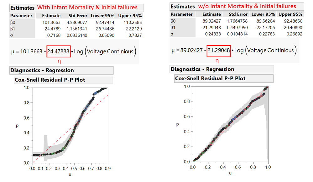

The problem is that fitting is poor when infant and initial failures are not excluded from model (see Figure 1 below).
As result it can be seen from Figure 2 that:
  • values of η and σ are significantly differ between Inverse Power models estimated with and w/o initial failures
  • Fitting with initial failures is poorly predicts Inverse Power model (see Cox-Snell Residual P-P Plot)

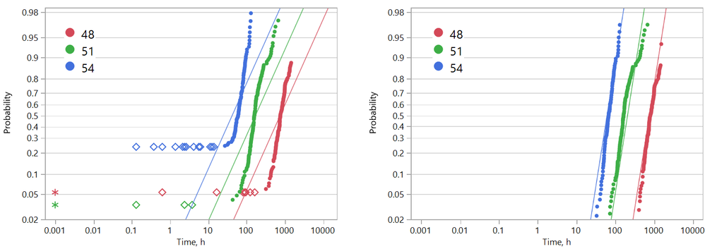

What I am trying to do is
  • fit Inverse Power model model w/o infant mortality and initial failures
  • and in same time keep showing infant mortality and initial failures on Fit Life by X graph
Note: The infant mortality (asterisk) and initial failures (rhomb) in left graph of Figure 1 are right-censored in JMP table

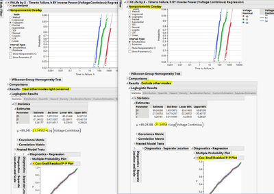

I attach both approaches to illustrate. First, the "time censor format.jmp". I keep "Time to Failure, h" untouched, but create a new column "Effective Censor" with this formula:
Then I use "Time to Failure, h" and "Effective Censor" as my time and censor indicator columns to analyze the data. The following is the screenshot of the comparison between "treating other modes right censored" and "excluding other modes". The scripts are in the table. The numbers are close, but I believe that we should treat other modes right censored here.

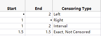

Now the other format: "interval format.jmp". The table defines "Start Period of Time, h" and "End Period of Time,h" as follows. This is "Start Period of Time, h"
And this is "Eng Period of Time, h"
Now I only use "Start Period of Time, h" and "End Period of Time,h"  for the analysis. And reports should replicate what are in the previous screenshot. The scripts are in the table.

I believe that interval format with right and left censored data is the best one see graphs below.
Graph with right and left censored data present points at probabilities where they are actually start contribute to fit.
Obtained parameters of fit are slightly differs between two variants, but no more than 1%.
