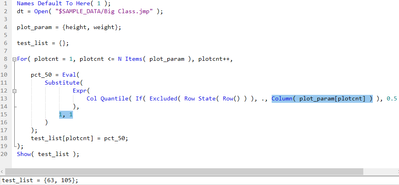

hogi
Level XIII
Re: Exclude rows in Col Quantile Calculation
Due to a typo, I just noticed that Eval (substitute()) is enough, even if you substitute 1 with 1:
Names Default To Here( 1 );
plot_param = {height, weight};
test_list = {};
For( plotcnt = 1, plotcnt <= N Items( plot_param ), plotcnt++,
	pct_50 = Eval( Substitute( Expr( Col Quantile( If( Excluded( Row State( Row() ) ), ., Column( plot_param[plotcnt] ) ), 0.5 ) ), 1, 1 ) );
	test_list[plotcnt] = pct_50;
show(test_list);
hogi
Level XIII
@LatentDataTiger , feedback from JMP Support (TS-00139301)
Yes, this is a bug.  The developers have verified it is a caching issue with Col Quantile [& Col Median] specifically.  The other Col functions do not have the issue.  Using Substitute makes a new expression with each iteration of the loop so that caching does not get used improperly.  Thanks for reporting this and I will file a bug report.
So, under the line, it's not Substitute, but the protection via Eval(Expr()) which fixes the bug.
