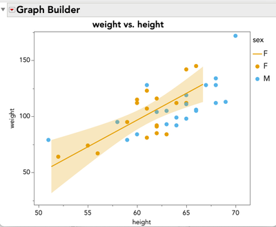

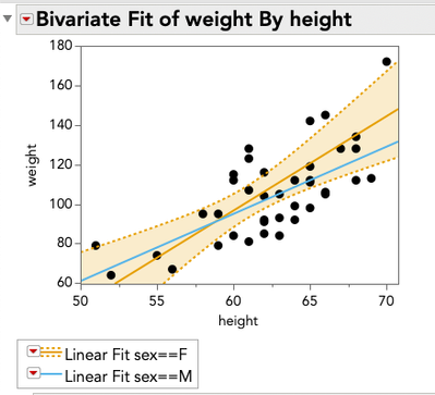

Its completely possible that I'm not understanding your question, but here are a couple things to try.

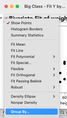

In the Fit Y by X platform, you can group the data by your column with the indicator for Train and Test (validation column)
Then fit a line, which will be separate lines for test and train.
To highlight the Train group, maybe try turning on the shaded and dashed lines for the confidence interval of the fit
I made an example figure with the big class.JMP data set
Graph builder can do something similar.
double click on the legend to get these menus:
I made the "M" line completely transparent, "0".

Lukas_Häfner
Level II
Re: Exclude data points from a regression line, but make them still visible in the diagram
Thank you very much for your detailed description! It greatly improved my diagram!

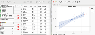

Using the Big Class dataset as an example: plot height vs weight and show all points but only plot correlation for Females.
Interactively:
- select Male rows in data table and exclude (but NOT hide).
- in Graph Builder: plot height against weight, set sex as Overlay variable, change from smoother to line of fit, then hold the SHIFT key and select "Show Excluded Rows" from the red triangle menu. The shift key is important because it unhides this usually hidden option.

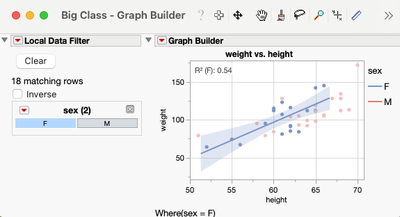

Via scripting, this time using a local data filter rather than excluding rows in the data table:
Names Default to here(1);
dt = open("$SAMPLE_DATA/Big Class.jmp");
dt << Graph Builder(
	Size( 300, 200 ),
	Show Control Panel( 0 ),
	Show Excluded Rows( 1 ),
	Variables( X( :height ), Y( :weight ), Overlay( :sex ) ),
	Elements(
		Points( X, Y, Legend( 3 ) ),
		Line Of Fit( X, Y, Legend( 5 ), R²( 1 ) )
	Local Data Filter(
		Show Controls( 0 ),
		Mode( Show( 0 ) ),
		Add Filter( columns( :sex ), Where( :sex == "F" ) )
Hope this helps.

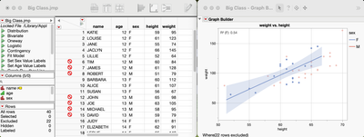

Level IV
I apologise if this posts twice. My first post seems to have vanished.
Using Big Class as an example: plot height vs weight but only show correlation using Female data points.
Interactively:
- in the data table, select Male data rows and exclude (but NOT hide),
- in Graph Builder: plot height against weight, set sex as Overlay variable, change smoother to line of fit, then with the SHIFT key pressed select  "Show Excluded Rows" from the red triangle menu (shift is needed to unhide this usually hidden option).
Using scripting, with a local data filter this time instead of modifying the table:
	Size( 300, 200 ),
	Elements(
	Local Data Filter(
		Show Controls( 0 ),
		Mode( Show( 0 ) ),
Hope this helps!
Lukas_Häfner
Level II
Thank you very much, this is also very helpful information!
