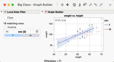

matth1
Level IV
Re: Exclude data points from a regression line, but make them still visible in the diagram
Using the Big Class dataset as an example: plot height vs weight and show all points but only plot correlation for Females.
Interactively:
- select Male rows in data table and exclude (but NOT hide).
- in Graph Builder: plot height against weight, set sex as Overlay variable, change from smoother to line of fit, then hold the SHIFT key and select "Show Excluded Rows" from the red triangle menu. The shift key is important because it unhides this usually hidden option.
Via scripting, this time using a local data filter rather than excluding rows in the data table:
Names Default to here(1);
dt = open("$SAMPLE_DATA/Big Class.jmp");
dt << Graph Builder(
	Size( 300, 200 ),
	Show Control Panel( 0 ),
	Show Excluded Rows( 1 ),
	Variables( X( :height ), Y( :weight ), Overlay( :sex ) ),
	Elements(
		Points( X, Y, Legend( 3 ) ),
		Line Of Fit( X, Y, Legend( 5 ), R²( 1 ) )
	Local Data Filter(
		Show Controls( 0 ),
		Mode( Show( 0 ) ),
		Add Filter( columns( :sex ), Where( :sex == "F" ) )
Hope this helps.

matth1
Level IV
I apologise if this posts twice. My first post seems to have vanished.
Using Big Class as an example: plot height vs weight but only show correlation using Female data points.
Interactively:
- in the data table, select Male data rows and exclude (but NOT hide),
- in Graph Builder: plot height against weight, set sex as Overlay variable, change smoother to line of fit, then with the SHIFT key pressed select  "Show Excluded Rows" from the red triangle menu (shift is needed to unhide this usually hidden option).
Using scripting, with a local data filter this time instead of modifying the table:
	Size( 300, 200 ),
	Elements(
	Local Data Filter(
		Show Controls( 0 ),
		Mode( Show( 0 ) ),
Hope this helps!
