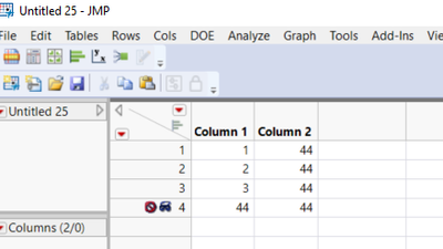

I found that when a row is Hide and Excluded, the data is still being used by a formula in another column.
Here is an example, Column2 formula is Col Maxium (:Coumn 1), row 4 is excluded and hidden, but the data is still being used by the formula in Column 2.
How to exclude data from row 4 so that it is not used by the formula in Column 2?

It might sometimes be a bit formula/function dependent but in this case adding Excluded() to grouping should work
Col Max(:Column 1, Excluded())

Col Maximum( If( !Excluded(), :Column 1 ) )
Thank you for the hint. Got the code.
