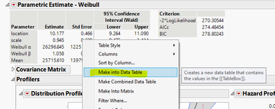

Right-click on the values in the estimates table and select Make Into Data Table. If you have a grouping variable in the By analysis role, then select Make Combined Data Table instead.
Is this result what you want?

Mark: Thank you for responding. How would I get the data that is generated in the Parametric Estimate - Weibull column format into a data table? Another point is, it takes quite a while to generate those numbers. Maybe my question should have been worded as, are there Formula functions available to generate those parameters?

Mark: I should have caught that about the right click but not seeing a red triangle available in the Parametric Estimate - Weibull section I was at a loss. Thank you for pointing this out. That solves the part about getting this tabulated data into a data table.
Re: JMP 16.2 Life Distribution Weibull Distribution Alpha/Beta Generation
This action works with any table of values in any platform. That feature is pretty nice, but it is not obvious. We are considering various user interface elements and designs that can help you realize when there is functionality right in front of you without cluttering the UI or distracting your work.

To save estimates in the report to a data table, try the following: Right click in the Parametric Estimate part, choose "Make into Data Table".

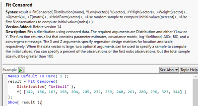

For your second question. There is a JSL function which can estimate Weibull parameters without going through Life Distribution. Following is the screenshot of it from Scripting Index. But I am not sure whether it is what you want.

  • You may want to try the JSL function that I mentioned above, if you have some JSL programming skill. The function allows arbitrary censoring schemes, just like what are supported in Life Distribution, but by passing estimating the non-parametric estimate using all data, if you call the function appropriately by specifying the last argument to use a sub-sample. The function will definitely no draw the non-parametric estimate, which will save time.
