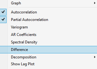

Do you mean the observations go up and down once is a cycle? Then based on the plot, the big jump might be a good indicator. The jumps are pretty large. To calculate jumps, you can generate them from Time Series platform directly. Look for Difference, then follow the steps accordingly. In the end, "Save" column from the Difference report.
Otherwise, using JMP column formula to generate the jumps is also straightforward. Right click on your data column, choose "New Formula Column", choose "Row", choose "Difference".

Yep, I understood correctly then. My suggestion was identify the jumps as I pointed out in the following screenshot. We won't be able to identify them in the raw form. But if you calculate the difference, which is the current row minus the previous row, these differences should stand out as big positive numbers. They will be your indicators of the starts of individual cycles. Then I guess that you need to come up a way to mark every segment by a unique value, followed by what @Mark_Bailey suggested.
