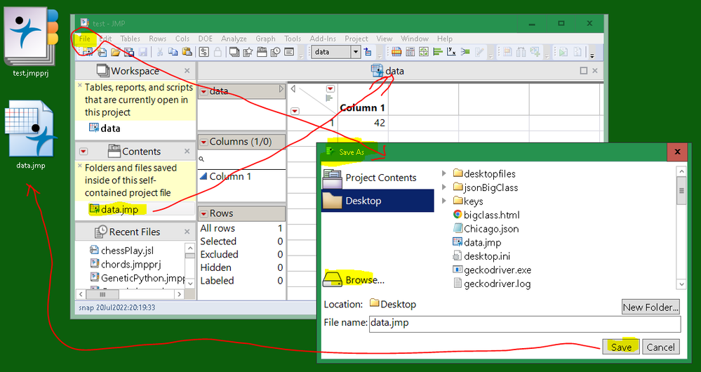

How do you save a useful table out of a jmp project for use in other analysis?  I have a feeling the answer is going to be similar to finding the sunglasses I'm looking for are already on my head...

I think this is what you are describing. I'm not sure if there is another way, but if the table is open in a tab and the tab is selected, then the file->save-as will work.
save from project to desktopsave from project to desktop
There is no export from the file's name in the content list.  @aaron_andersen
Craige
Re: Save file out of jmp 16.2 project
Thanks, @Craige_Hales. That's probably the easiest method. (Alternatively, you could use the Window->Move to/from Project dialog to move the table in question out of the project).
