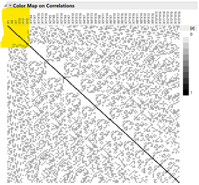

Designs with no confounding between the main effects might show an alias matrix like you are getting. This should be the usual expected behaviour for screening design types.
When I build a custom design in JMP only including the main effects the color map of correlations looks like this:
You can see that there is no correlation/cofounding between the main effects (yellow area), but a lot of correlation between higher order terms.
The alias matrix has a different purpose which Ryan explained down below.
Usually you want check the color map of correlations in your report for correlation/confounding properties of the design.

Here is what the color correlations look like. I used only the main effects in alias terms. The alias matrix is a 1s and 0s, but the color correlation map has some off diagonal terms that are not 0.  next reply i will show what i did outside JMP.

heres another image , iused main effects in model terms, and added both main efects and 2nd order interactions in the alias terms. You can see in the color map correlations the dark block of 2nd order vs 2nd order. but main effects vs main effects and main effects vs 2nd order are about the same light grey color . Why then does the alias matrix list 0s for the main effects vs main effect off diagonals but various numbers for the main effect vs 2nd orders.  Again im sure its just something im not understanding.
Re: Evaluating a Design Matrix for aliasing(confounding) in R and JMP have different answers
The Alias Matrix reflects what happens to terms in your model when you do not include them. The rendering is not quite right, but you'll see if your "Z" (i.e. the columns reflecting the alias terms) are the same as your model terms, you'll get the identity matrix you're seeing.
https://community.jmp.com/t5/R-D-Blog/What-is-an-Alias-Matrix/ba-p/30448
Those correlation between your model terms (you don't need them in the alias terms to see this) will increate the standard error of your parameter estimates when you fit the model. The Estimation Efficiency outline helps you see just how much larger it would be compared to if you could make all those effects perfectly orthogonal:
https://www.jmp.com/support/help/en/18.1/index.shtml#page/jmp/estimation-efficiency.shtml
I like to use the Color Map as a quick look into the properties of the design, whereas the Estimation Efficiency/Alias Matrix when I'm considering which terms are in the model vs. not.
