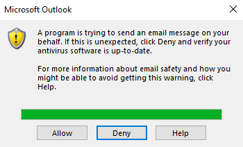

issue 3): can JSL auto select the "Allow" when it appears without human interaction? (see below)

You could send the email by using vbscript or powershell and call those with JSL. For example with Powershell you can send email with HTML body and in there you can embed images of graphs and embed tables.
