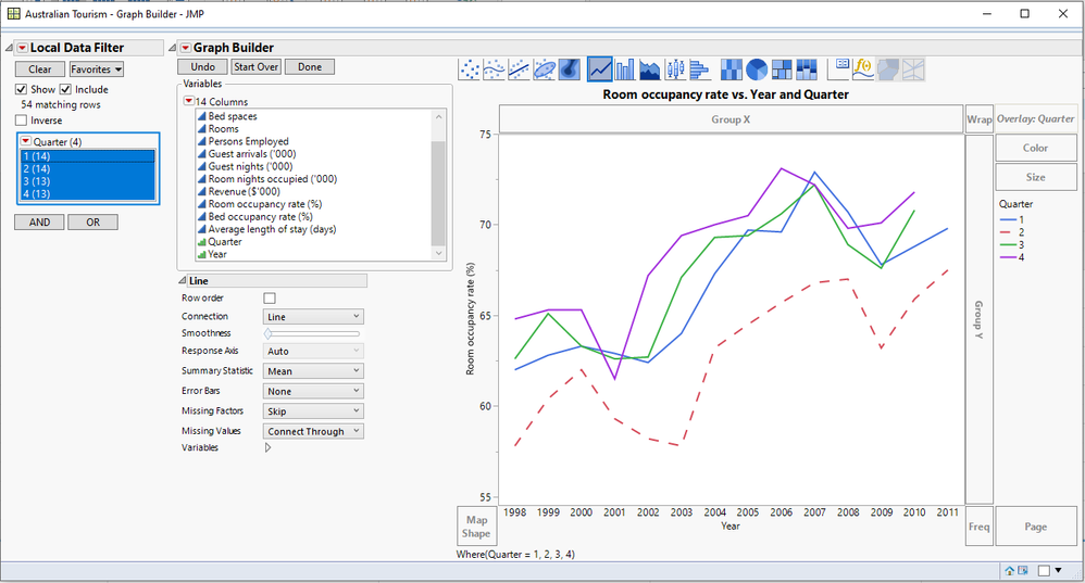

I would like to know if and how it is possible to always have a fixed line style/color based on a certain criteria (e.g. in the case below based on the Quarter).
If you take the sample data file "Australian Tourism" and plot the Room occupancy (%) versus Year you would get something like below,
where I changed the line style for Quarter 2 to be dashed.

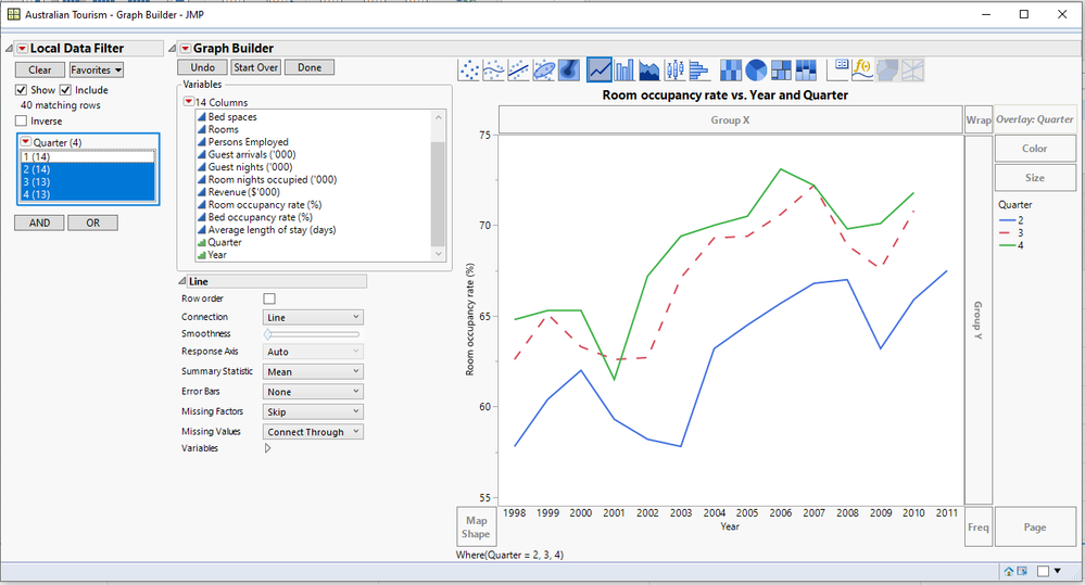

However when I select only Quarters 2,3 and 4 the graph changes to:
I would like to have Quarter 2 still in Red dashed, Quarter 3 still full green and Quarter 4 still full purple.

A simple solution is to assign colors to the Quarter values: Column > Column Properties > Value Colors. This will tell JMP to use your choice instead of the default colors which do change upon selecting different groups in the Local Filter as you observed.
