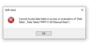

Error for JMP 15 users that JMP 16 PRO users don't have with querying a table with JMP addin Script
I have JMP 16 but and have no issues with my JMP addin query working. JMP 15 users have an error when running the below and don't get the table.

Re: Error for JMP 15 users that JMP 16 PRO users don't have with querying a table with JMP addin Script
I am surprised that this function call ever works. It takes 3 arguments, not 4 arguments. The first argument is for the connection. The second argument is the SQL. The third and optional argument is the name of the resulting data table.
jthi
Seem very weird that error has table name as All Manual Data and script is using Year Manual data. Year somehow gets replaced with All in JMP15?
Based on documentation (jmp.com) there seems to be two optional arguments, visibility and table name.
Open Database(dataSourceName|"Connect Dialog", "SELECT ..."|"SQLFILE..."|tableName, <"Invisible"|"Private">, <outputTableName>)
-Jarmo
