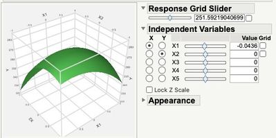

@statman Also thank you for your response. I checked the surface also in the model view but I cannot gain anything from that unfortunately since some surfaces show a maximum and some a minimum.

I ran the model you had saved to the data table.  Not sure if this is the model you are evaluating, so if not some of my comments be inappropriate.
The model needs work.  The residuals are suggesting non-constant variance and you have insignificant terms in the model.  The statistical significance seems to be based on the center point replicates and higher order quadratic interactions (your error is not based on randomized replicates).  Not sure what you mean by your comment about response surfaces?  You should get something like the following (though this is using your model):
