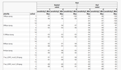

Hi,
In above graph I looking to add a 3  columns "Delta1, Delta2, Delta3" to the right which evaluates difference between values rxAnt 1,2,3 for Kestrel and rxAnt 1,2,3 for Owl resp i.e
Delta1 = -97 - (-98) = 1
Delta2 = -97 - (-98) = 1
Delta3 = -100 - (-100) = 0
Can we do this?

Easiest option might be to create them first into the data table as formula or use Summary table instead of Tabulate. Col Min() and Col Max() are useful functions if you create them into your original data table (you could also use Transform column in tabulate but I think creating them into the data table is easier).

Hi,
Thank you the reply. It helps. I created the diff columns by creating data table from tabulate. It looks like this below:
Now I would like to color values >1 in columns  ANT1, ANT2, ANT3 in green, <=1 in red.
I want it to be displayed in tabulate itself
How can I do this?

I don't think you can color the rows in Tabulate. You can make it into a data table and then color the rows there (it will look a bit different though), but in that case it might be better to just create Summary table and color that.
