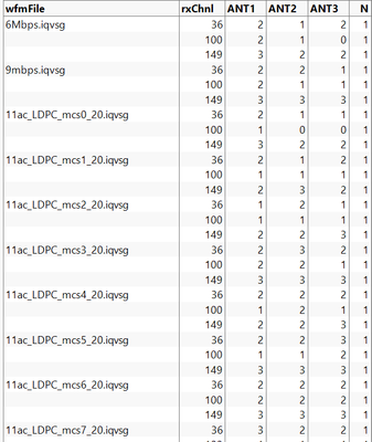

Thank you the reply. It helps. I created the diff columns by creating data table from tabulate. It looks like this below:
Now I would like to color values >1 in columns  ANT1, ANT2, ANT3 in green, <=1 in red.
I want it to be displayed in tabulate itself
How can I do this?
Thank you

I don't think you can color the rows in Tabulate. You can make it into a data table and then color the rows there (it will look a bit different though), but in that case it might be better to just create Summary table and color that.
