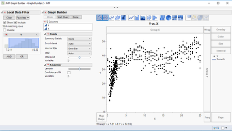

The smoother should be drawn as long as there are at least 2 points remaining. Can you display what you are seeing so it can help the community figure out the issue

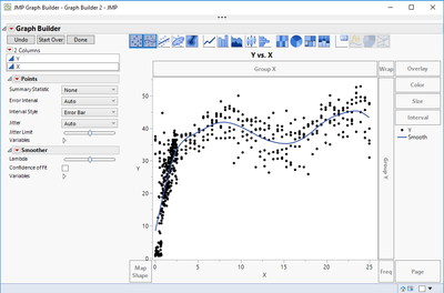

Below are two screenshots of the graph builder with and without a local data filter applied. The smoother disappears in all my JMP tables when I apply a data filter to any column.  Please let me know if there is any other information that would be helpful.
