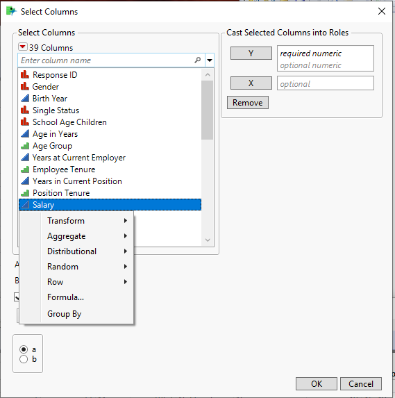

A Column Dialog() will provide you those options.  Here is the example from Column Dialog() taken from the scripting index

I've tried Column Dialog and it certainly offers the option to manipulate columns. However, I was hoping to implement that option in the context of 'new window'.
In order to better guide the user through their options, I've split the columns into 3 panels. I only want to offer the option to transform columns in Panel 2. i
I don't think 'column dialog' would offer me the flexibility to split the columns in multiple selection panels.
Any suggestion to be able to invoke the same right click menu in the context of  'new window' as for 'column dialog'.
