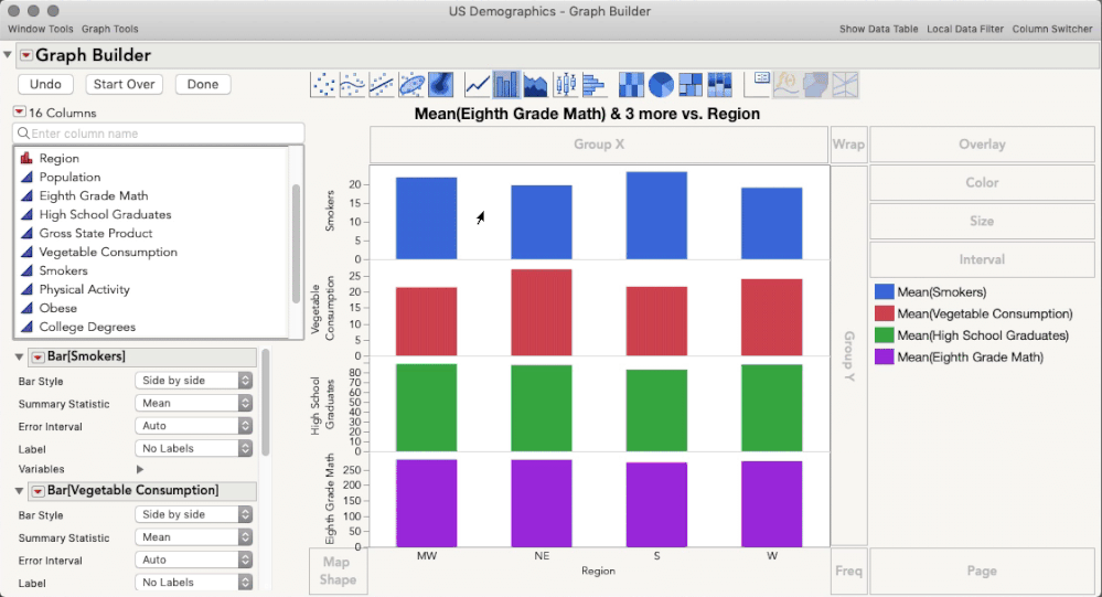

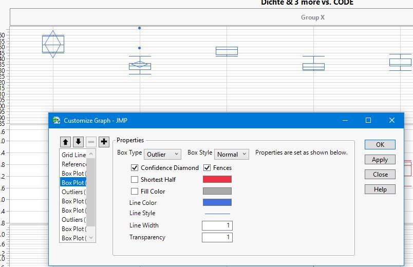

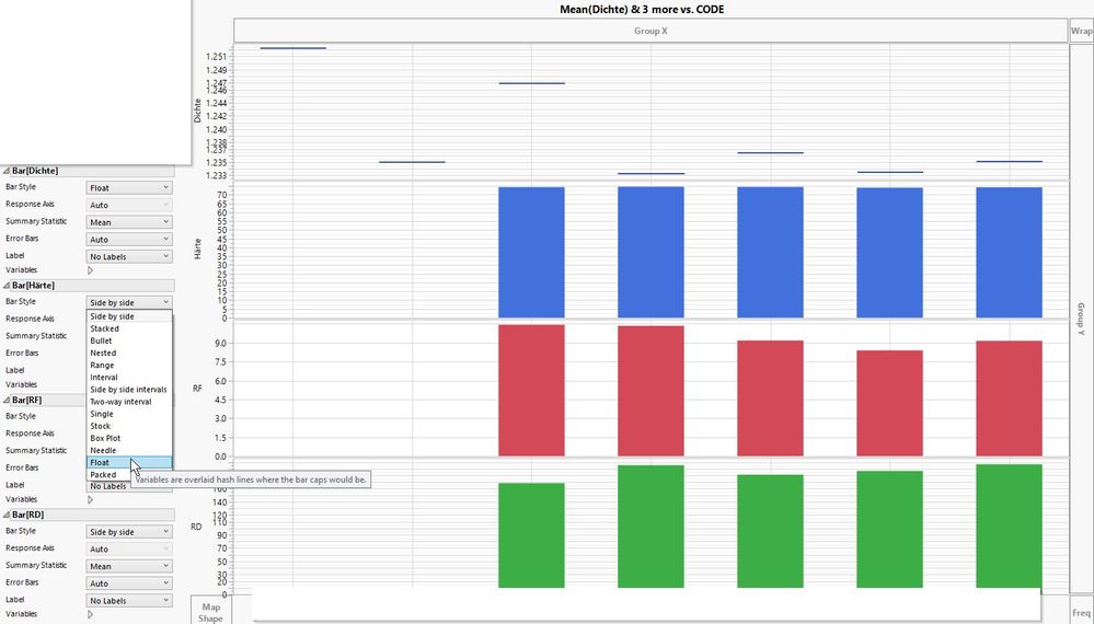

Dear all, is there a easy way to edit the style for several y-axis in graph builder. For instance I want to change all bar graphs to float style at one, or I want to have on every box plot the confidence diamond. How can I do this without changing every axis or for the box plots every box individually. Thank you

Method 2: Broadcast Changes to Elements
If you're just changing element properties/styles, you can broadcast a change by holding down the control key (or the command key, on a mac), and then Right Click one of the plots, then make your change. This will "broadcast" that change to other plots in Graph Builder. Note that you need to do this by right-clicking the plot, not in the elements control panel on the left. Also, this method will not work for customizations you wish to make in Right Click > Customize.
Method 3: Copy Customizations, then Broadcast Customizations
To standardize customizations you make in a plot (using right-click > customize) you can use the same broadcast method, but after copying the customizations. Right-click the plot you have customized > Edit > Copy Customizations. Next, hold the control key (or command on the mac), then right-click any plot > Edit > Paste Customizations.
