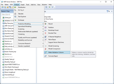

Assuming you have JMP Pro, this would be done in before you start the multivariate analysis, in the Analyze...Predictive Modeling...Make Validation Column menu selection.
