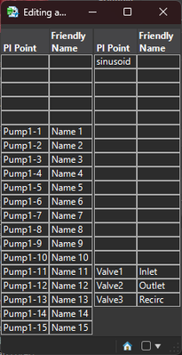

Is there a way to allow users to select, or appear to select, multiple cells in a Table Box, or is there a different object I could use instead? To illustrate the use case, a user might want to move the pump tags from the left table to the right starting on row 2 in the image below. How would they select the block of cells to copy and then paste them?
New Window( "Editing a data table",
Show Menu( 0 ), Show Toolbars( 0 ),
h list box(
Table Box(
String Col Edit Box( "PI Point", Repeat( { "" }, 5 ) || Transform Each({v},as list(transpose(1::15)),"Pump1-" || char(v)) ),
String Col Edit Box( "Friendly Name", Repeat( { "" }, 5 ) || Transform Each({v},as list(transpose(1::15)),"Name " || char(v)) )
spacer box(20,20),
Table Box(
String Col Edit Box( "PI Point", {"sinusoid"} || Repeat( { "" }, 14 ) || {"Valve1", "Valve2", "Valve3"} ),
String Col Edit Box( "Friendly Name", Repeat( { "" }, 15) || {"Inlet", "Outlet", "Recirc"} )
Scripting the copying and pasting the values should be straight forward, but the user needs to indicate where to get data and where to put it.
The Actual Use Case
I want to improve the Aveva/OSISoft PI Tools add-in interface by replacing the text box entry for tags and friendly names with a data table, as discussed on an issue in github. Often users have a list tags in a JMP table or a spreadsheet, and they want to quickly copy/paste them into the add-in user interface. Simply copying the entire table at once is easy enough, but then if a change is needed they might want to just replace a section of the list.
With the Table Box object it doesn't appear a user can select multiple cells, is there another option here? At one time I thought you could embed an entire data table window inside of a user defined window, but maybe I dreamt that.
So far my best idea is some sort of mouseover logic that draws squares over 'selected' cells, but I first want to see if there is a simpler solution.

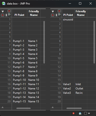

names default to here(1);
dt1 = New Table( "dt1", invisible,
Add Rows( 20 ),
New Column( "PI Point", Character, "Nominal", Set Values(
New Column( "Friendly Name", Character, "Nominal", Set Values(
dt2 = New Table( "dt1", invisible,
Add Rows( 20 ),
new window("data box",
h list box(
ntb1 = dt1 << New Data Box;
ntb1 << close side panels;
ntb1 << Set Row ID Width( 50 );
ntb1 << Set Width(200);
ntb1 << Set Height(450);
ntb1,
spacer box( Size( 20, 20 )),
ntb2 = dt2 << New Data Box;
ntb2 << close side panels;
ntb2 << Set Row ID Width( 50 );
ntb2 << Set Width(200);
ntb2 << Set Height(450);
ntb2
<< On close(
try( dt1 << Close Window );
try( dt2 << Close Window );
I am still working through some aspects of these - like how to resize the column width inside that box after the table is drawn - but that is for another day!
