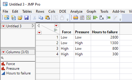

After a full factorial design was executed I have the following tabulated results:
Force
Pressure
Hours to failure
15 N (Low)
10 Pa (Low)
2800 hours
15 N (Low)
150 Pa (High)
1300 hours
100 N (High)
10 Pa (Low)
800 hours
100 N (High)
150 Pa (High)
300 hours

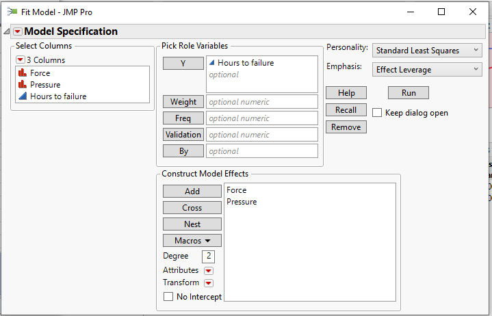

How would I determine the main effects of Force and Pressure? I've added this data to a table, my next move would be to Analyze > Fit Model and figure out to make a Least Squares Mean Plot. Having a hard time setting that up in the Fit Model.
txnelson
Re: Easy: Determine Main Effects
Enter your data into a data table
Go to
     Analyze=>Fit Model
enter in the model you want to analyze
And click OK
Jim

txnelson
Did you only measure one Hours to failure for each combination of Force and Pressure?
Jim
Yep, you got it!
txnelson
Go to
     Analyze=>Fit Model
And click OK
Jim

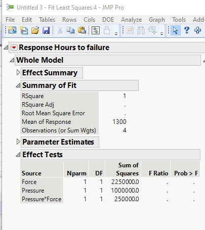

statman
Eric, welcome to the community.  Jim provided the steps to do exactly what you want.  I would simply add...why not also get the interaction effect while you're at it.  3 total DF's P+F+PF
txnelson
@statman
Not enough df
Jim
statman
Ummm, yes there are.  I always start with a saturated model, use Normal, Bayes and Pareto plots as well as look at parameter effects and SS.  Use engineering knowledge and predictions about potential effects to then reduce the model.  I really don't place much weight on p-values as YOU control these via how you collect your data.  So, for example, if you leave the interaction out of the model, guess what...the interaction is the estimate of mean square error and is therefore the basis of the statistical test (F-test). For unreplcated designs, I much prefer the unbiased Daniels plots, but that's just me.
txnelson
I stand corrected.....
