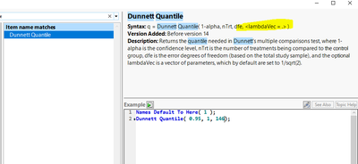

some body can help me on this formula, why i cannot give 4 numbers on this ?

My guess is that it is related to the other inputs you are using Dunnett Quantile(1-alpha, nTrt, dfe, <lambdaVec=.>)  (I'm not familiar with this function).

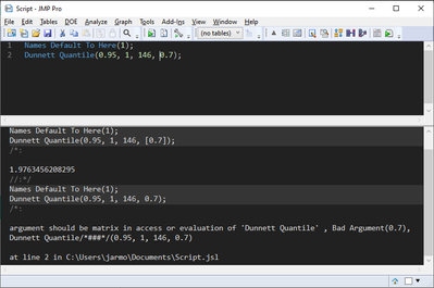

my formula is so simple, but somehow JMP inform error on lamdaVec
Names Default To Here(1);
Dunnett Quantile(0.95, 1, 146, [0.7]);

For me your example works fine (using JMP 17.2)
If lambdaVec isn't matrix it will throw an error (0.7 instead of [0.7])
