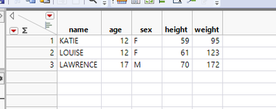

Have you looked at JSON to Data Table()?
result = "\[[
  "name" : "KATIE",
  "age" : 12,
  "sex" : "F",
  "height" : 59,
  "weight" : 95
  "name" : "LOUISE",
  "age" : 12,
  "sex" : "F",
  "height" : 61,
  "weight" : 123
  "name" : "LAWRENCE",
  "age" : 17,
  "sex" : "M",
  "height" : 70,
  "weight" : 172
dt = JSON to Data Table( result );
result = "\[[
  "name" : "KATIE",
  "age" : 12,
  "sex" : "F",
  "height" : 59,
  "weight" : 95
  "name" : "LOUISE",
  "age" : 12,
  "sex" : "F",
  "height" : 61,
  "weight" : 123
  "age" : 17,
  "sex" : "M",
  "height" : 70,
  "weight" : 172
