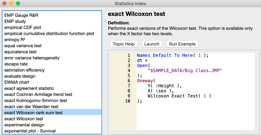

txnelson
Re: Does JMP still have a function called Exact Wilcoxon Rank Sum test?
I assume your data has more than 2 groups in your Oneway analysis.  The test is only available if the X Factor column only has 2 levels. Below is the documentation taken from the Scripting Index

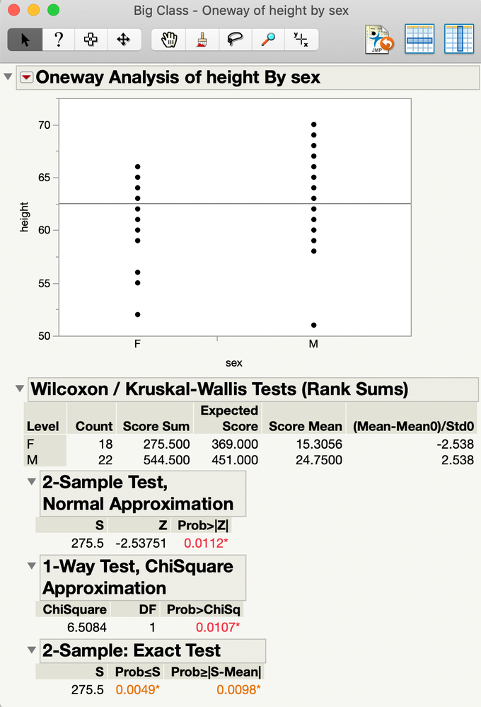

I found it is still listed in the latest version of JMP:
It still works, too:
