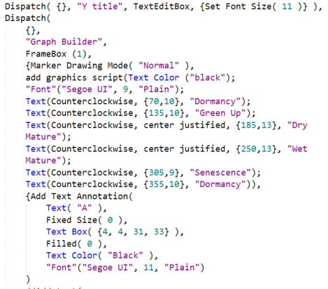

I'm running JMP Pro 16.1.0 and I have an issue that is driving me insane. I have a fairly complex figure with tons of data.  I need to add some text labels to it so I can describe different periods of time. The text needs to be rotated so that it will fit in the space and read well. I read on a post that Text Annotations cannot be rotated counterclockwise, but plain old text text can.  So I added my text labels as shown in the script below:

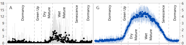

When I run the script, the figure is PERFECT.  Took a long time to get to this point.  I am super happy with it in JMP, this is what it looks like:
Here is my problem: When I export/save the graph as an SVG, the text rotation is lost as is shown below:

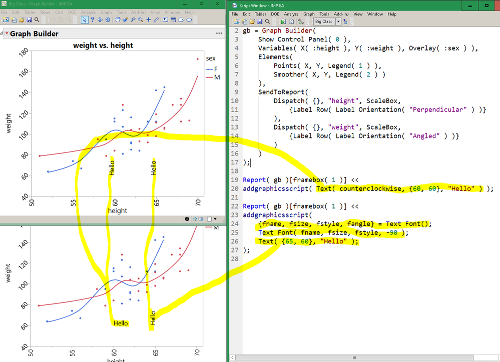

Looks like a bug. You can work around it like this:
Use the TextFont command to specify the font name and rotation.Use the TextFont command to specify the font name and rotation.
@Audrey_Shull - the bottom graph is the saved SVG, opened in an external viewer, Firefox in this case.

Report( gb )[framebox( 1 )] <<
addgraphicsscript( Text( counterclockwise, {60, 60}, "Hello" ) );
addgraphicsscript(
	{fname, fsize, fstyle, fangle} = Text Font();
	Text Font( fname, fsize, fstyle, -90 );
	Text( {65, 60}, "Hello" );

Re: When I save figure as SVG, text rotation is lost.
Thanks for the example @Craige_Hales - we opened a ticket with the dev team, but it's nice to have this workaround documented too.

Hi Craige -
It works!!!  The text exports perfectly.
Thank you, thank you, thank you!
