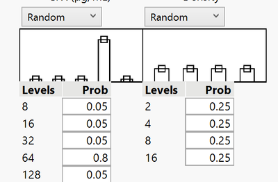

However, when I come to the prediction profiler in JMP17, when I select Random - it gives me the 5 different levels that I used when creating the discrete numeric variables associated probabilities to set rather than a normal distribution.
What can I do to be able to model the variation in the factors as a normal distribution in order to optimise for robustness?

Before launching the analysis, you'll want to change the Design Role column property for each factor from discrete numeric to continuous. To do this for all discrete numeric factors at once, select all of their columns in the data table, right click on one of the selected column headers and choose Standardize Attributes. Choose the Design Role property in the Column Properties drop-down menu and change to continuous, then click OK.

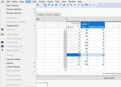

Hi Ross, I was just trying to do this in the Easy DoE mode in JMP17 but unfortunately it doesn't seem like this is possible as I can't right click on the factor column headers nor can I 'standardise attributes' from the control bar.
Is there a way to do this in Easy DoE?
Re: DoE - Setting Factor Values to test for a Continuous Variable
You cannot generally edit the same things for implementation reasons as you can in a JMP data table or Custom Design. JMP 17 introduces Easy DOE, which we will enhance in the future. We are researching ways to remove some restrictions and add new features in a future release. We hope to make the changes addressed by @Ross_Metusalem available in the Define step because we do not want you to export a data table, make such a change, and then load the data table back into Easy DOE.

Thank you Mark for replying so quickly and clarifying this! That would be really helpful to have the ability to change the design role of the columns in the design step of Easy DoE! Looking forward to future releases!
You will likely have to return to the Define step, but that action requires just one click. The design of this complex object requires careful additions of features and clarifying the role of each step. There might be more than one way to accomplish a task in time, but the initial way will be the safest and most direct possible.
