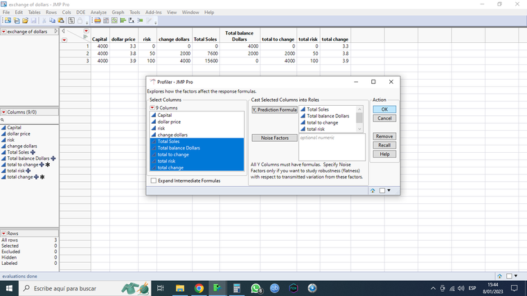

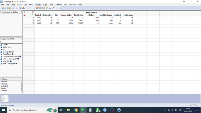

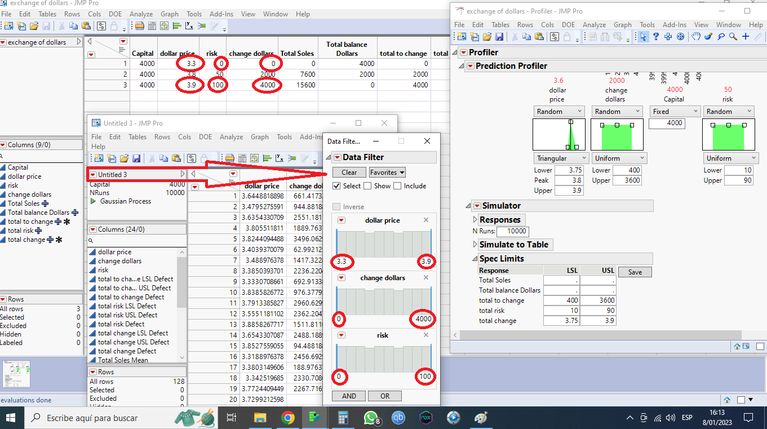

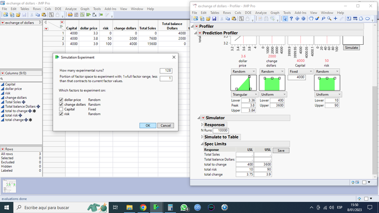

A query,....... when using the "Simulation experiment" option and specifying the distributions Triangular for dollar price, Uniform for change dollar, Uniform for risk, indicate in "Specification limits" ....total change : LSL = 400 USL= 3600, total risk: LSL = 0 USL= 90, total change: LSL=3.36 USL= 3.9, indicate 128 experiments, 1 (full range) and run the simulation experiment.... JMP uses the ranges of the "exchange of dollars" table.......lines below I detail the procedure with images.....what am I doing wrong?
