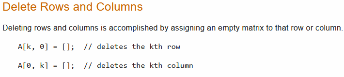

If you print yval and yrow, you see they are not similar (unless you transpose yrow). You can also use Dim() on the matrices to see how they differ
show(yval,yrow);
yval = [59, 61, 55, 66, 52, 60, 61, 51, 60, 61, 56, 65, 63, 58, 59, 61, 62, 65, 63, 62, 63, 64, 65, 64, 68, 64, 69, 62, 64, 67, 65, 66, 62, 66, 65, 60, 68, 62, 68, 70];
yrow = [1 2 3 4 5 6 7 8 9 10 11 12 13 14 15 16 17 18 19 20 21 22 23 24 25 26 27 28 29 30 31 32 33 34 35 36 37 38 39 40];
Then I just made a good guess based on the okayish error message
Inserting an empty must be to whole row or column in access or evaluation of 'Assign' , yRow[del] =  /*###*/[] /*###*/
I think you could also do it without transposing
yRow[0, del] = [];
Scripting Guide > Data Structures > Matrices in JSL Scripts > Subscripts in Matrices
show(yval,yrow);
yRow[0, del] = [];
