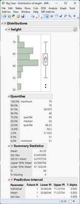

For me it does get recorded to the log if I do it manually first. I have this report

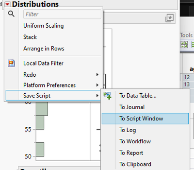

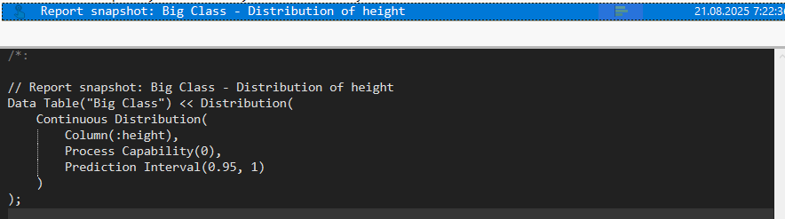

And if I copy script from red triangle I get the following
Distribution(
	Continuous Distribution(
		Column(:height),
		Process Capability(0),
		Prediction Interval(0.95, 1)
And if I close the platform (that is the moment when log gets the "proper" script for the platform, otherwise it is just Launch script if even that)
