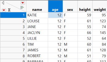

How can I interact with the table in data table box()? For example, when I want to select a specific cell, the table displayed by data table box() cannot be selected. How should I modify it so that I can select a cell within the table shown by data table box()?
In the JSL script below, is it possible to manually select the cell where KAITE's Age is 12? Like the selection shown in the image below.
The purpose of doing this is to allow users to select the desired cell, so that the cell value can be modified later.

Data Table Box is in reality Table Box with Data Table Col Boxes, so I think you might be limited to row selections. You could try using Data Grid Box()

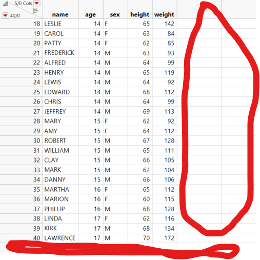

Based on the following JSL, I have two questions.
(1) Regarding the red marked area in the figure below, is there a way to remove it? I want to display a table that fits just right. The blank margin area around it has no meaningful purpose.
(2) After pressing "Show Table" in the JSL multiple times, the displayed table area becomes smaller and smaller. How can I keep it fixed at the original size?

Re: How can I interact with the table in data table box()?
1. You can use Set Width to force width of the table. You might have to do some calculations to get it exactly what you wish it to be.
Names Default To Here(1);
nw = New Window("Example",
	Button Box("Show Table",
		Try(x << delete);
		temp << append(x = Data Grid Box());
		x << Set Data Table(dt);
		x << Close Side Panels(1);
		x << Set Width(420);
	temp = V List Box()
2. You can keep it from getting smaller for example by preventing V List Box from auto-stretching (there are also other possibly better options)
